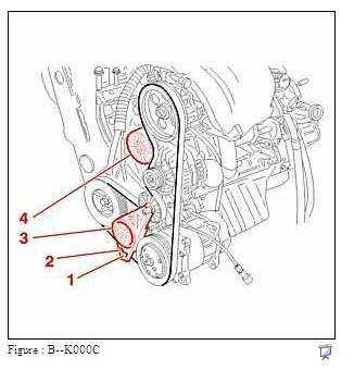

Hi Paul.  Peugeot has a procedure for removing & resetting aux belt but not for alternator itself as far as I can see (it'll be obvious).  Procedures differ depending whether you have power steering or not.  Assuming a Y-reg will have PS as I think they started fitting it as standard after a certain date so that's what's below.  Change aux belt if hasn't been done recently.  Suggest you get a 306 Haynes manual off Fleabay - many available for less than £5.
Adjustment square (1).
Setting hole (2).
Automatic tensioner (3).
Roller tensioner (4).

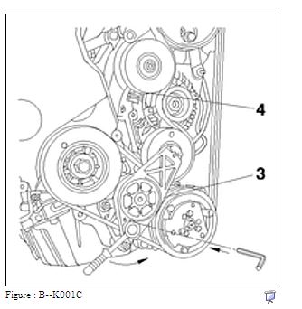

Slacken the belt by moving the tensioner (3).
Peg the tensioner (3) with a 4 mm allen key.

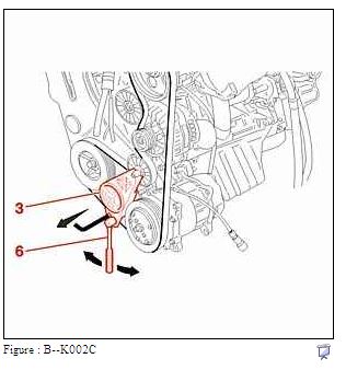

Manoeuvre the tensioner (3) to detach the rod.
Using the spanner (6), move the tensioner (3) until the belt is tight.
