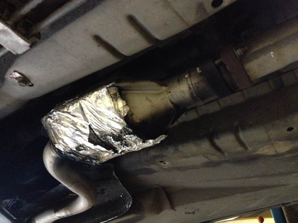

Cat gone...
No longer smokes + it revs to about 5 grand before the governor kicks in. Winning
Also seeing as all it has is a back box standard now the cat is gone it sounds epically agricultural.

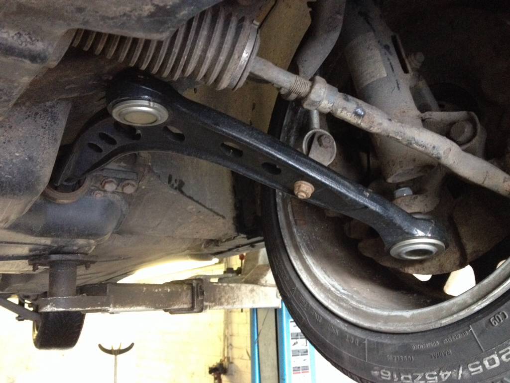

The old cat was blowing really bad... The previous owner had wrapped it in heat wrap and kitchen foil :/
Also the wishbones seem to be brand new and someone has already done the rear brake pipes, ideal Smile
