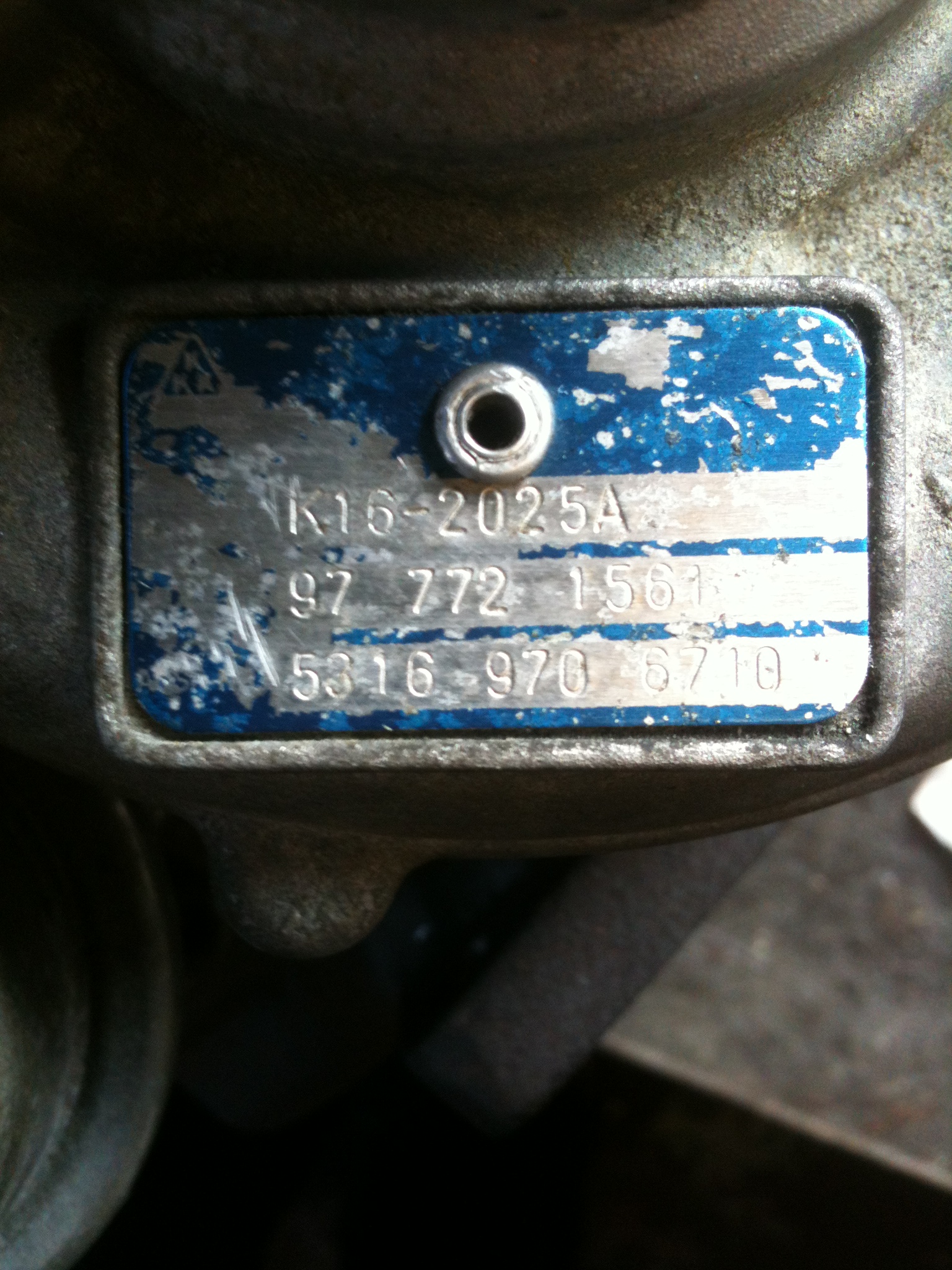

hi folks, just a quick question to see if anyone has used a kkk k16 on an xud if so what is it capable of, just picked one up for peanuts and fitting is pretty easy too, the stock k14 elbow bolts straight up Smile
this one is from a rover 2.5 tdi i think, I am only looking for a reliable 140-150 hp, i know a t2/k14 can run to 130-140 but dont think it would last very long at that pressure.
anyhow had a quick measure up, its fully mounted to the k14 manifold in the pics..
k14 ind wheel 35mm - 50mm at base
k16 ind wheel 37mm - 55mm at base, hot side is bigger too..
RE: k16 turbo - Piggy - 03-03-2013
I looked into it...its similar to the td04 I believe in size and potential...going on when I asked and the turbo maps
RE: k16 turbo - Ruan - 03-03-2013
Yeah, shouldnt be too bad to be fair, only thing is that hotside is going to probably make it boost quite late in the RPMs... It'll do what youre asking, but when you inevitably get bored of that power, it'll struggle... But they're quite strong tbf..

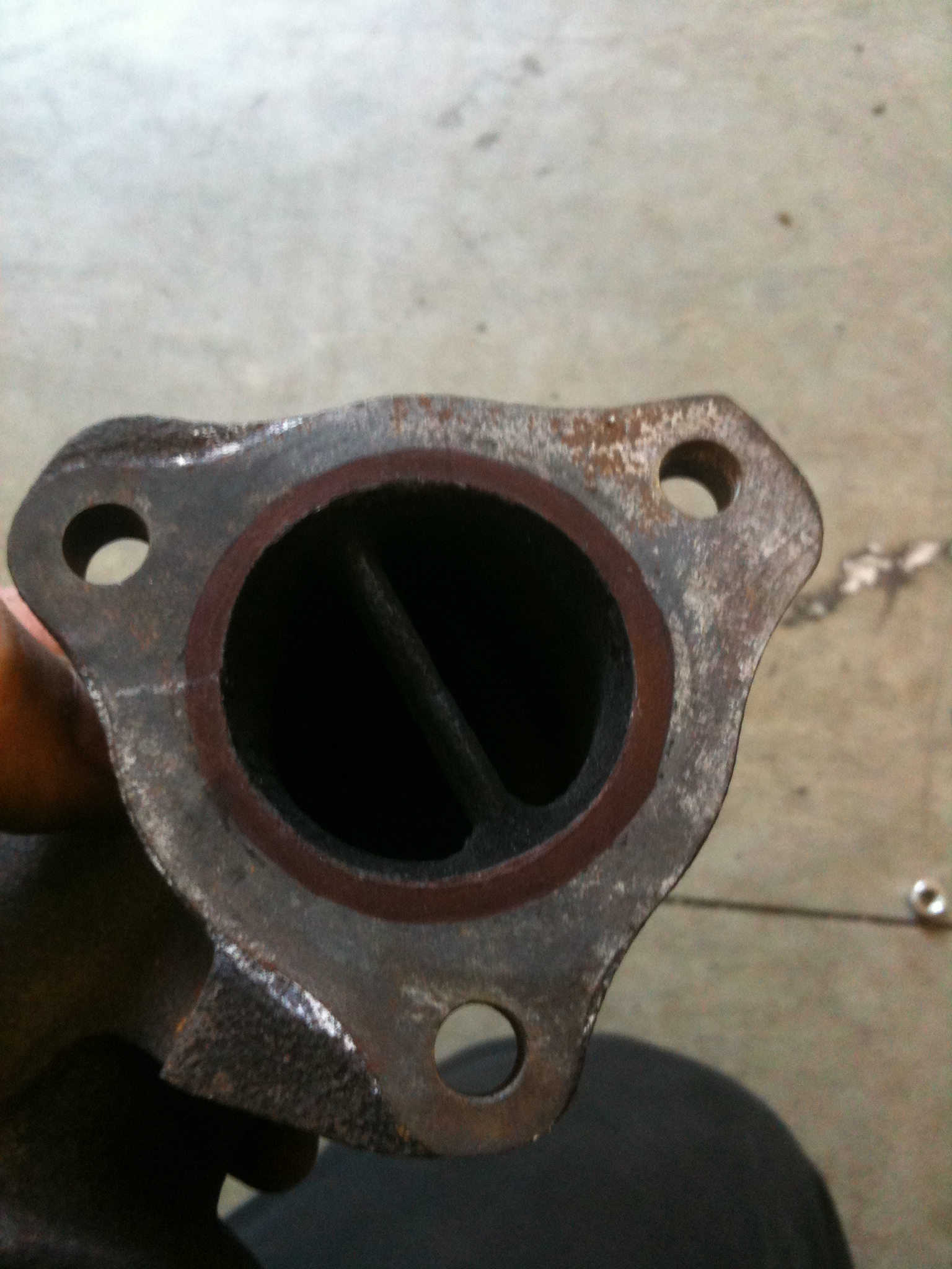

ok just thinking of flowing the k14 elbow out to the mark you can see in the pic, but what the hell does the little flat fin in the middle do Confused Do i need to keep this or can it go.,, only thing i can think it does is break up the spinning exhaust gases, but i may be talking absolute sh#t lol
RE: k16 turbo - con67 - 04-03-2013
Definitely get rid of that divider thing and open the elbow as much as you can, I did and it was a pretty big difference.
RE: k16 turbo - billing5 - 04-03-2013
(04-03-2013, 09:39 PM)con67 Wrote: Definitely get rid of that divider thing and open the elbow as much as you can, I did and it was a pretty big difference.
ok will get rid if its not important, still puzzled as to what it does though Undecided anyone know!!
RE: k16 turbo - strictly_perv - 04-03-2013
Interesting build. I wonder how it compares to the K04 on mine. Oh and that divider I think it there for a restriction.
RE: k16 turbo - zx_volcane - 04-03-2013
+1 for this, cut it out and open it up as much as you can Smile

RE: k16 turbo - RJDubya - 04-03-2013
Think the centre fin in the appature is to help with airflow, reduces turbulence and increases the efficiency of the outlet. I could be wrong but i cant see them putting it in there to restrict as they would just make a casting with a smaller outlet for that as it'd be cheaper to do.

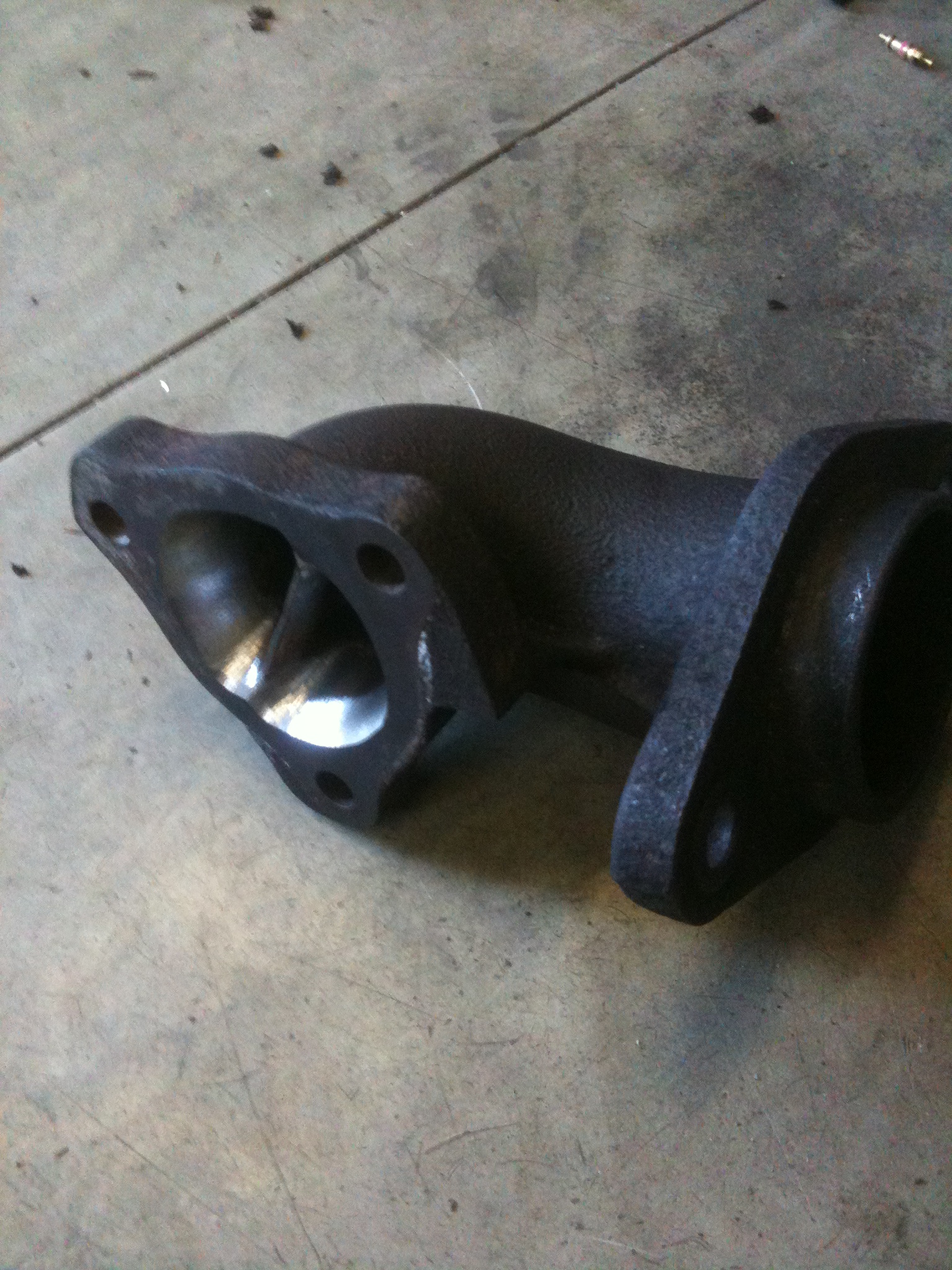

RE: k16 turbo - billing5 - 07-03-2013
Ok so ground out the elbow yesterday after some digging on the net found it do indeed help flow so left it in, also decided to flow the entry on the turbo while I was there as it had quite a step!! should be fitting this very soon with a bit of luck, but got the mot soon so need to get the usual done bottom arms etc...
RE: k16 turbo - con67 - 08-03-2013
Mmm, flow for 92bhp, i'd have cut it out tbh.
RE: k16 turbo - billing5 - 08-03-2013
(08-03-2013, 03:30 PM)con67 Wrote: Mmm, flow for 92bhp, i'd have cut it out tbh.
well they must have put it there for a reason, makes the casting more awkward to produce, costly way of doing something pointless. google it....
RE: k16 turbo - silverzx - 08-03-2013
What have you used to bore it out? Looks a fairly tidy job.
RE: k16 turbo - Tom - 08-03-2013
Die grinder i reckon. My dremel isnt manly enough for a neat job like that. Then again mines shit :/
yep, air die grinder with rotary burr. made short work of it, but had to take care on the turbo though... finished the turbo with 240 wet n dry after to remove the cutting marks.
RE: k16 turbo - con67 - 09-03-2013
I dont need to google it, I drove my car every day for ages with the standard hotside and elbow, then drove it with it bored out and minus the divider with virtually no other changes, it was much better. I'm *not* edit lol trying to say your wrong and I'm right or what ever, just sharing my own experience, I too diyed a bigger k14 on to mine ya see....

RE: k16 turbo - Dave - 10-03-2013
It dosent take a degree in fluid mechanics to work out what would be better here, just look at any other exhaust off any other high performance turbo!

RE: k16 turbo - GP123 - 12-03-2013
Im with Con67 here. Ive actually just done the same to my K14 elbow now as well for going onto my TD04 turbo. It would make sense to make as much flow as possible for a bigger turbo. Well i will see the results when i get it put on later.
RE: k16 turbo - RJDubya - 12-03-2013
Sense doesn't actually factor into it with French engineering! They probably just saw a pretty picture in the penguin book of turbos and thought it was a good idea.
Joking aside though, I will agree with you lads on these turbos but on a higher flowing turbo the fin is there to guide the air and reduce turbulence... Without doing a lot of maths it's difficult to prove but it is right :-)
