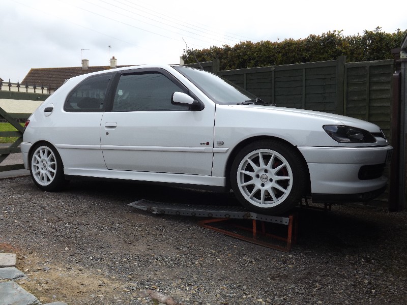

RE: Cully's Bianca 6 R150 YVM - cully - 15-05-2013
pictures of the first polish of the dirty girl!
cant belive how black white paint can get
super resin polish on a machine
followed by a poor boys wax

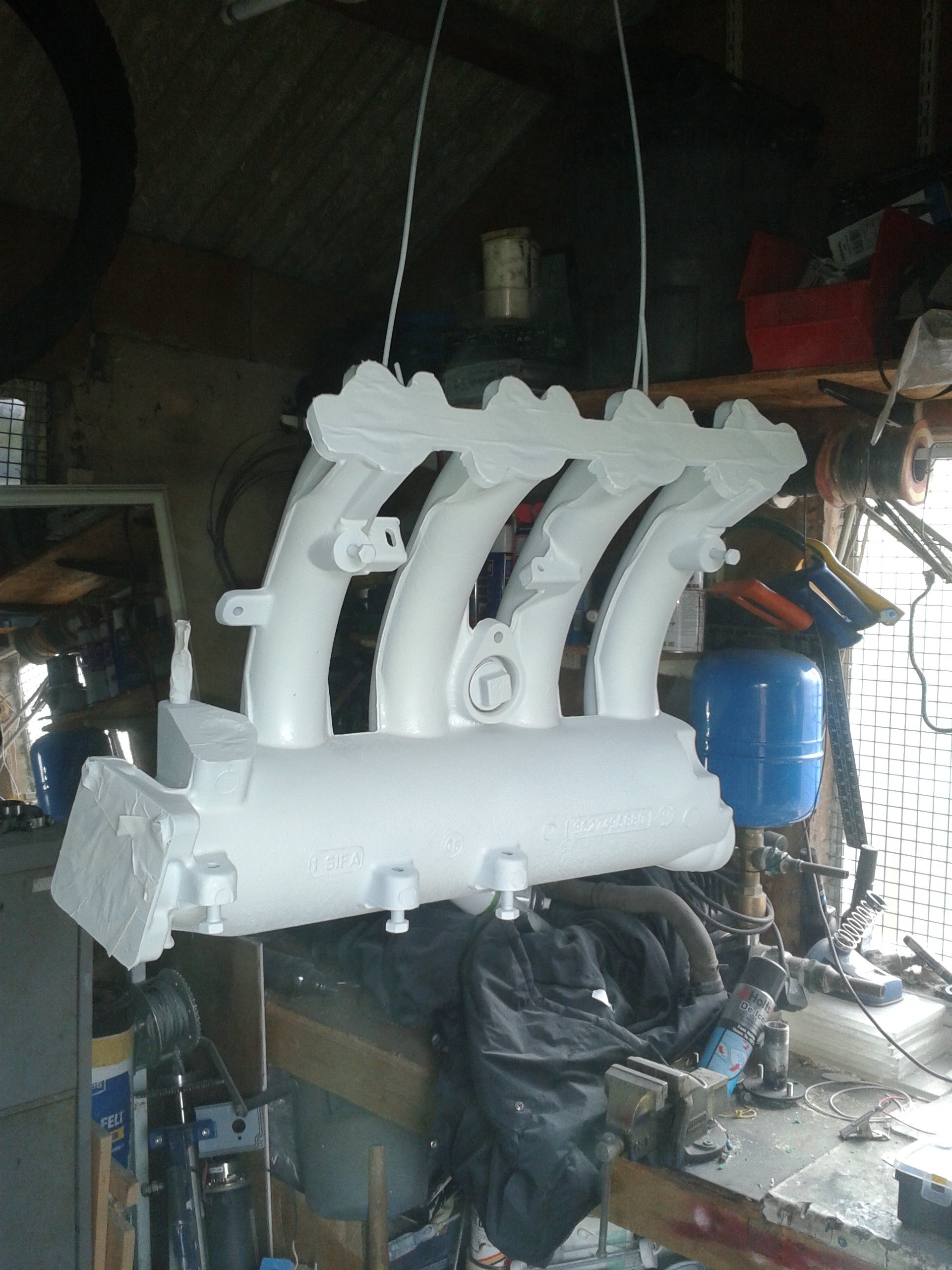

i have started the primer coat on the inlet manifold
RE: Cully's Bianca 6 R150 YVM - Dum-Dum - 19-05-2013
White manifold will look awesome.
RE: Cully's Bianca 6 R150 YVM - cully - 19-05-2013
(19-05-2013, 05:43 PM)Dum-Dum Wrote: White manifold will look awesome.
yes it will

top coats going on

just pulled off the masking tape from the manifold
dont think it looks to bad for a can job!
