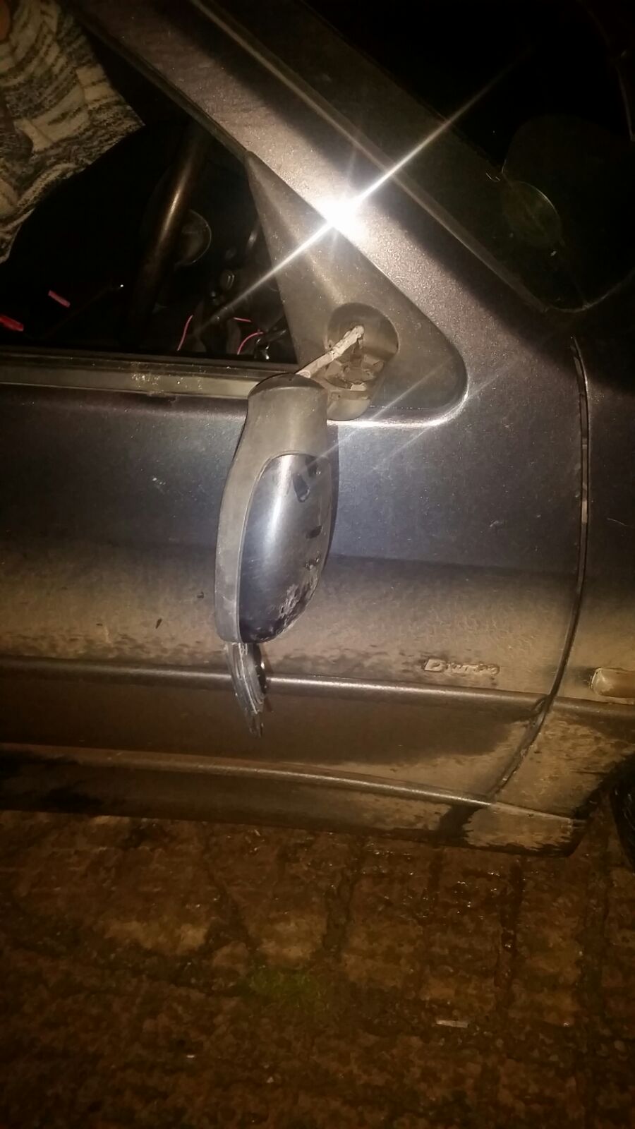

RE: Astor hdi, paddle clutch and many new things - ozonehostile - 06-11-2015 (02-11-2015, 07:25 PM)Pugmarshall Wrote: I bet you're glad you were persistent now! Sounds like it's going to be a good all-rounder. Needs more pics I'm still not sure if it was a good purchase or not haha, the clutch is slipping again and it's leaking diesel. Just to top off how unlucky this car seems to be for me, some mong in a polo driving on the wrong side of the road smashed my mirror off tonight! [attachment=undefined] RE: Astor hdi, paddle clutch and many new things - Matt-Rallye - 07-11-2015 Did you catch a reg or catch the driver? Im still saying this car is cursed
RE: Astor hdi, paddle clutch and many new things - Iaitoo - 07-11-2015 (06-11-2015, 10:16 PM)ozonehostile Wrote: Just to top off how unlucky this car seems to be for me, some mong in a polo driving on the wrong side of the road smashed my mirror off tonight! Same thing happened to my car. Damn them drunk drivers! RE: Astor hdi, paddle clutch and many new things - ozonehostile - 07-11-2015 (07-11-2015, 08:04 AM)Matt-Rallye Wrote: Did you catch a reg or catch the driver? Im still saying this car is cursed I couldn't see their front or rear plates they were following too close to the car in front of them and there was a line of cars behind them. All I saw was it was a 2004 silver polo, so if you see one missing the drivers mirror on your travels... :p
RE: Astor hdi, paddle clutch and many new things - Matt-Rallye - 07-11-2015 If someone asks at work for a mirror i'll get an address
RE: Astor hdi, paddle clutch and many new things - ozonehostile - 07-11-2015 (07-11-2015, 10:07 AM)Matt-Rallye Wrote: If someone asks at work for a mirror i'll get an address excellent sir :p If I see them driving around today ill certainly be having some very strong words aha RE: Astor hdi, paddle clutch and many new things - ozonehostile - 10-11-2015 Can't believe my bad luck with this car! The f*cking clutch is slipping worse than before I changed it and the release bearing sounds like the bell housing is full of gravel. All brand new parts and only lasted 350 miles trying to bed them in. Looks like the 2nd clutch Change in a month coming along
