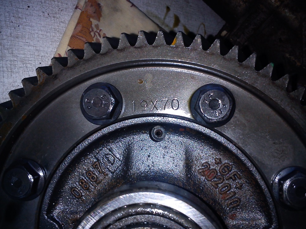

So here's the diff off the ECO box
And heres the proof its not the right ratio.

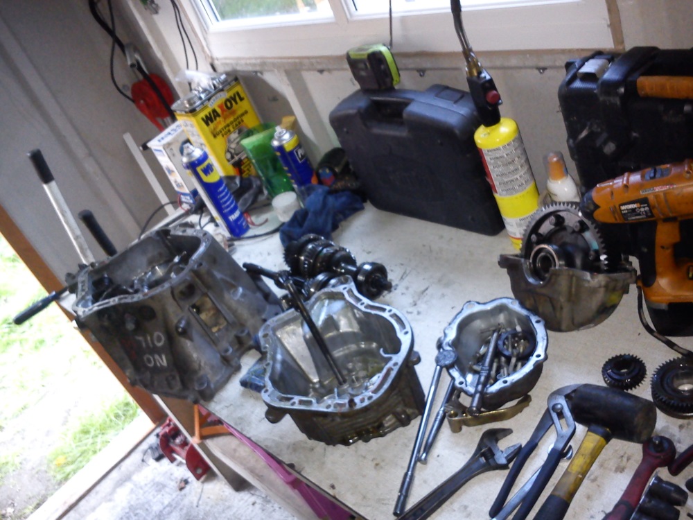

So I finished stripping the box, I used the nine inch to cut the nuts off the ends of the shafts and managed to pull 5th off then split the box in half and lots of bits fell out.

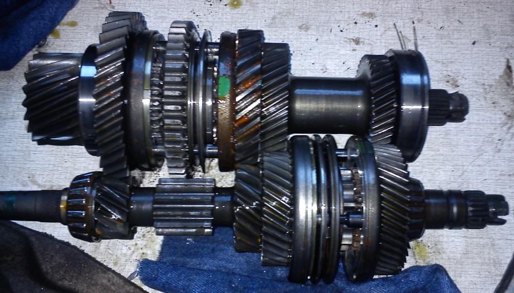

Heres the gears out the inside. From left (engine end) to right
Final drive (the one on its own), 1st, synchro, 2nd, 3rd and 4th with a gap where I f*cked 5th off to get it apart
And the resultant mess. The casing is going to become a wood burner or a BBQ once Ive smashed some more out of it.

Many hours i have spent in service box looking at 206 and 306 boxes mate. I know how many teeth every cog on every gear on any noteworthy box has.
