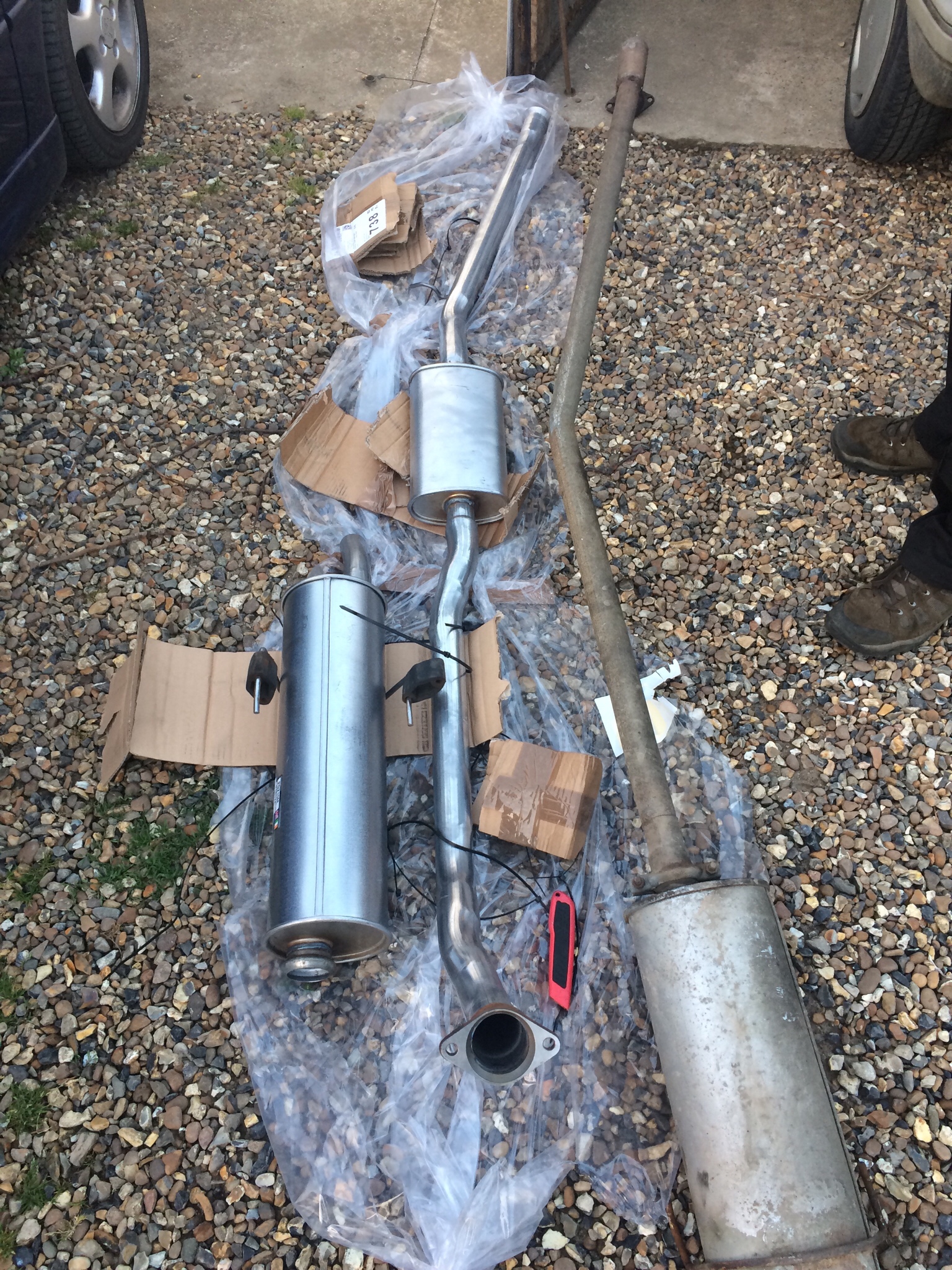

RE: 205 - XUD td conversion - Doseph - 30-04-2017
So i've been driving around for a week with the turbo engine and its been totally problem free apart from some the noise and sometimes gases caused by the "modded" exhaust. Luckily the new one showed up late Friday.
I managed to cram the full exhaust system into the 205... being basically the length of the car this took some persuasion but this time without a hammer.
Went down to Tom's and he got the elbow swapped over and fitted new exhaust fitted, then off for a test drive Big Grin
Oh My God this thing is rapid now! I couldn't believe the acceleration first time i put my foot down. Absolutely mental!

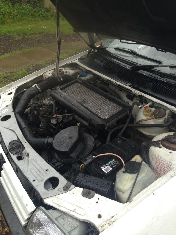

205 - XUD td conversion - Doseph - 07-05-2017
Got a few little bits done this weekend.
new rocker cover gasket - hopefully an end to the leaky engine.
sorted out an air intake and did some minor air flow modifications to the grille. probably makes no difference but hey hoe.
[Image: c0389401f35d1bb0cf30b8eb4b950331.jpg]
While doing this i noticed the temp sensor on my rad is leaking Sad
I'm starting to get used to the fact that whenever i fix something, i will find a new problem
My engine bay is looking seriously gross now, i think the only fluids that havent leaked yet are brake and washer fluid....
[Image: c647dd9ddf5eb2ed5ece1b86c339bb64.jpg]
But I'm having a blast driving this around in full sleeper spec, although i do want to get some better brakes, wheels and lower suspension on next Smile
RE: 205 - XUD td conversion - Paul_13 - 07-05-2017
That's been cross threaded in
RE: 205 - XUD td conversion - Doseph - 07-05-2017
(07-05-2017, 08:19 PM)Paul_13 Wrote: That's been cross threaded in
I don't think so, just the washer and its taken from a weird angle.... either way a replacement is in the post
RE: 205 - XUD td conversion - Frosty - 08-05-2017
Whats the new exhaust you got from? A turbo diesel 205 i guess? Poss may change mine as it touches the main gear rod
205 - XUD td conversion - bashbarnard - 08-05-2017
Its an srdt one. Standard fitment on them. Buy whole system and will direct fit the 306/205 turbo with no knocka or bangs Wink

(08-05-2017, 12:20 PM)Frosty Wrote: Whats the new exhaust you got from? A turbo diesel 205 i guess? Poss may change mine as it touches the main gear rod
as Bash said its 205 STDT exhaust from klarius, £100 all in. Its actually a surprisingly good fit, totally worth it.
