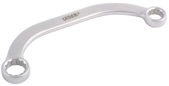

It was off a ZX if memory serves me correctly Smile can't see why it would be different though, its the same engine, unless it has a different cam cover maybe? Just move the studs in the lucas one and swap them over Smile
also find that these are amazing for getting to that bottom bolt......failing that a 13mm spanner cut in half works nearly as well

Re: Rattle coming from Throttle Arm (on Bosch) - darrenjlobb - 26-04-2012
Heh mark that laser spanner is almost exactly the same as the "correct" bosch spanner for the job!
