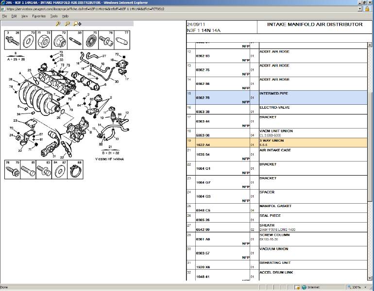

That the solenoid in the pic you put up above?
Re: S16 flat - aggyj17 - 28-01-2013
Yes mate. i got a brand new one from pug about a year ago was about £20
part number 16 electro valve
S16 flat - Frosty - 28-01-2013
Ideal cheers. That's on gearbox side under the vacuum pump?
I need to get on the computer to hand some Rep out Smile
yes mate.
Cool. Will report back tomorrow night with how I get on
